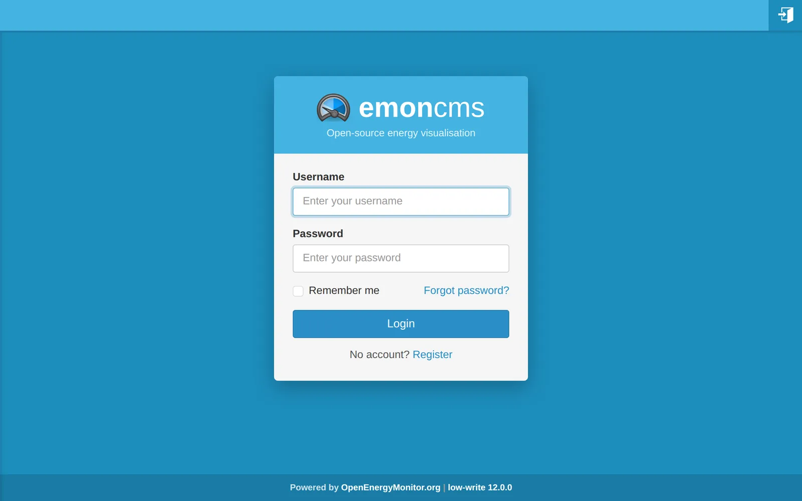

  • Open its address in a browser, for example http://emonpi.local. The Emoncms login page appears.
Login page
Log in
Log in with username emonsd and password emonsd. Change the password afterwards on the My Account page.
Emoncms opens on the Feeds page. It is empty until you create feeds.

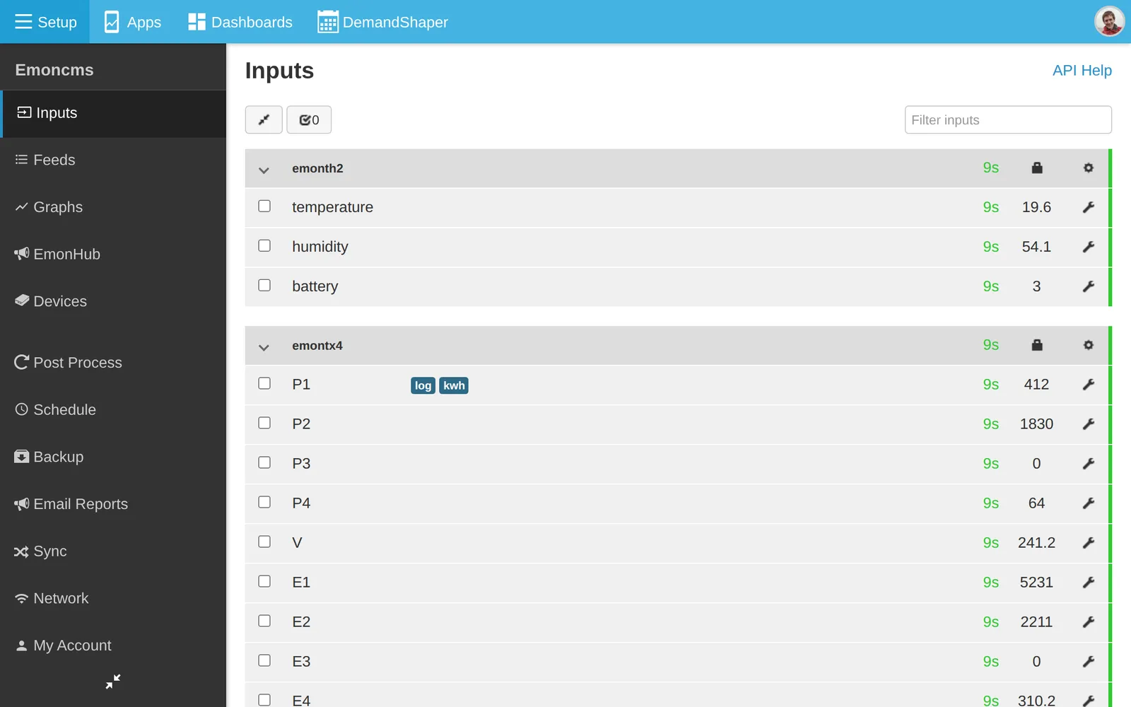

Check your inputs
Go to Setup > Inputs. Data from the emonPi, and from an emonTx or other node sending to an emonBase, appears here automatically.
Each input holds only its latest value. To record history, log the input to a feed. See Core concepts.

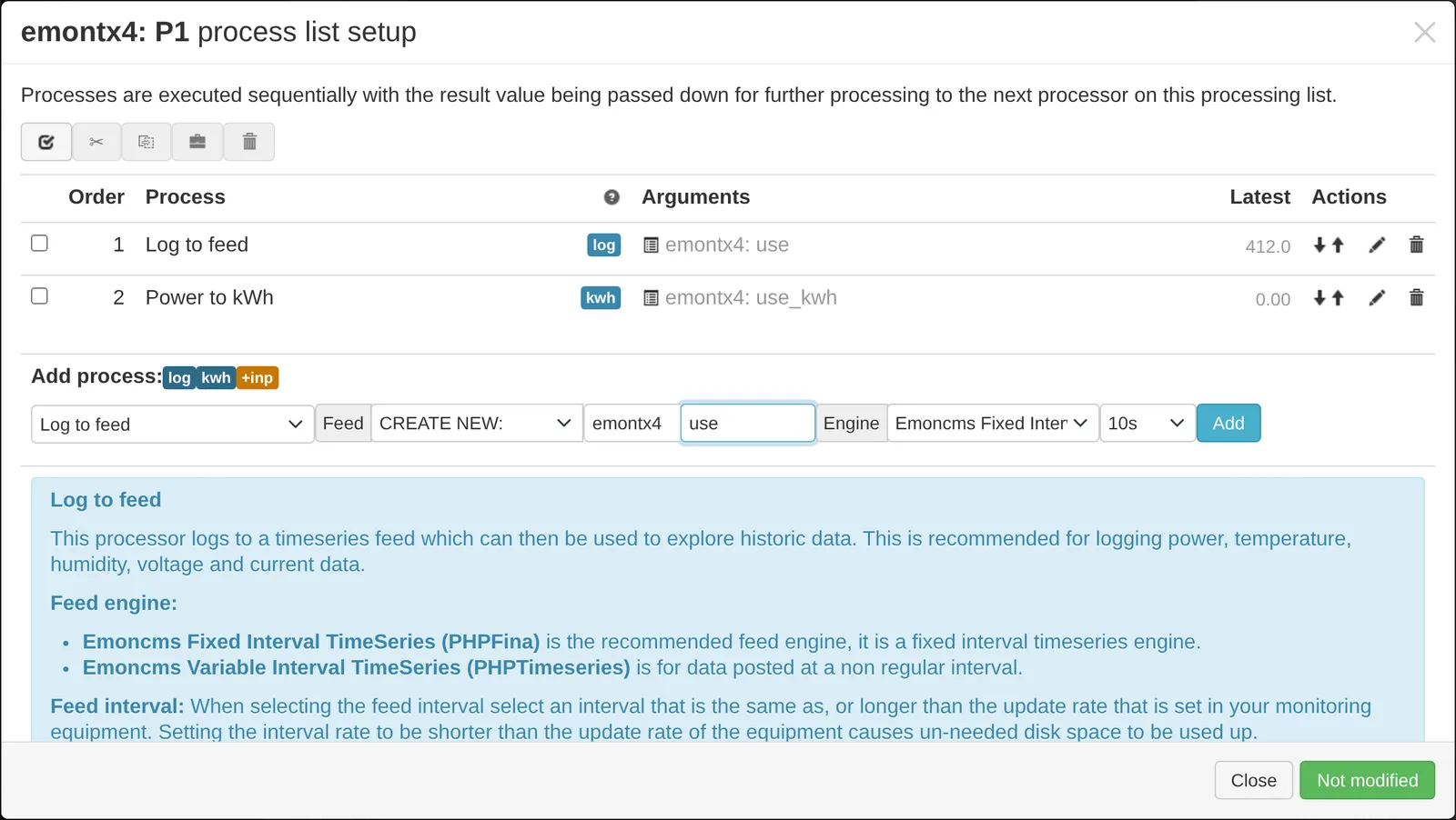

This example logs a power input, such as P1 from an emonTx4, and creates a cumulative kWh feed from it.
  1. Click the spanner icon on the input.
  2. In the process list dialog:
    • Select Log to feed.
    • Under Feed, choose CREATE NEW: and enter a name, for example use.
    • Leave Engine set to Emoncms Fixed Interval TimeSeries.
    • Select an interval of 10s for an emonPi or emonTx, or 60s for an emonTH.
    • Click Add.
    Log to feed with a new feed

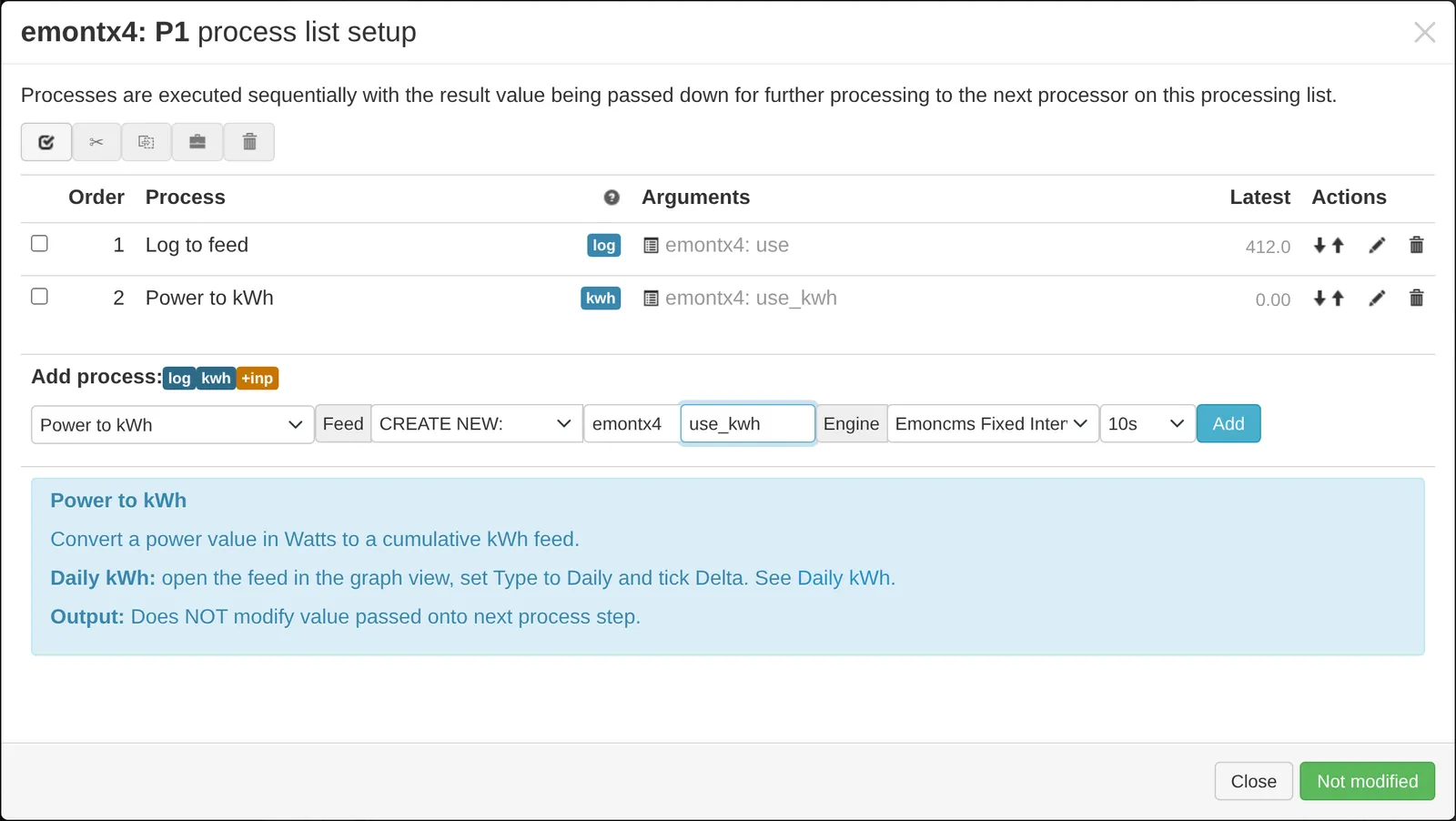

  3. To add daily kWh for a power input:
    • Select Power to kWh.
    • Create a new feed, for example use_kwh, with the same interval.
    • Click Add.
    Power to kWh with a new feed

  5. The input now shows its processes as short labels, such as log and kwh.
    Inputs with log and kwh labels

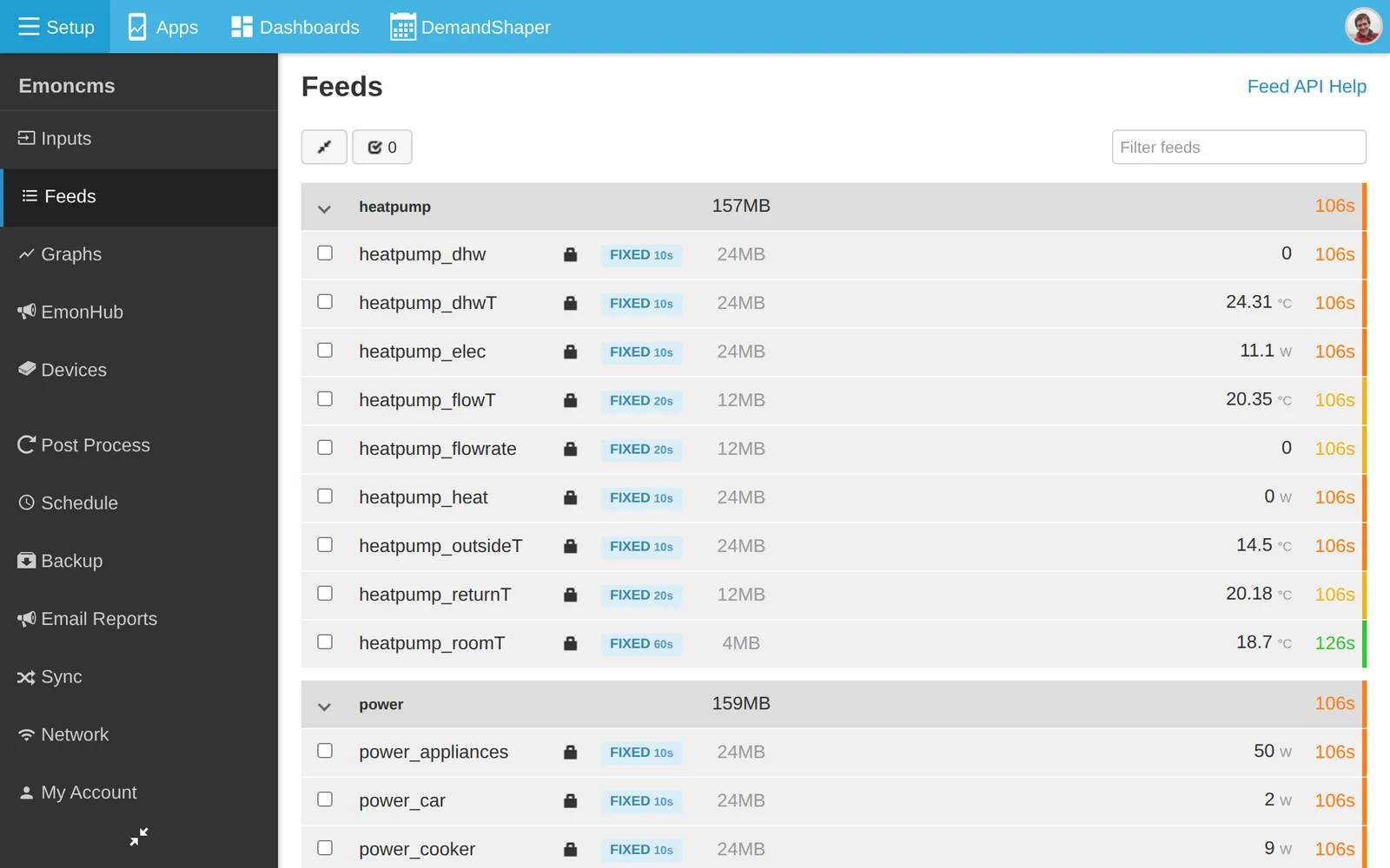

View the data
Go to Setup > Feeds. The new feeds are listed and update every few seconds.
Feeds page

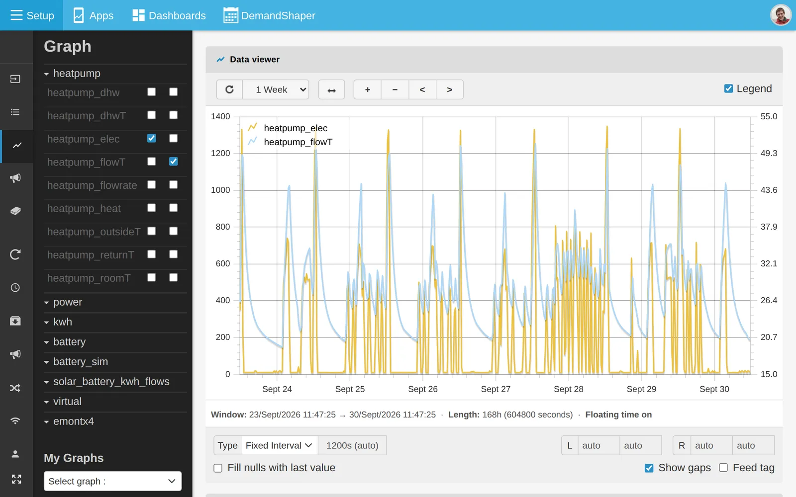

Click a feed to open it in the graph view. There is little data at first. Zoom in to the last few minutes, or come back later.
Graph view
