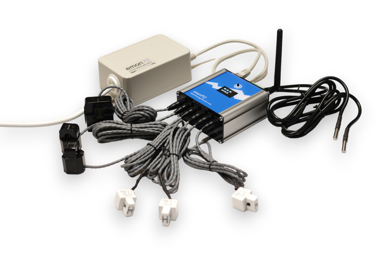

emonPi3 Complete Kit

emonVs installation
There are two different ways of installing the emonVs voltage sensor:
Using the mains plug supplied: If you have a convenient socket nearby this will be the easiest and quickest option.
Direct installation: The emonVs can be hardwired by a suitably competent person into a 6 A or lower circuit protection device in the fuse board (consumer unit) or a 3 A fused spur. The supplied emonVs mains power cable has a cross sectional area of 1.0 mm2. This can provide a tidy installation if no socket is available and helps ensure higher monitoring uptime if sockets are at risk of being unplugged for use by other appliances.
The emonVs unit can be wall mounted using the brackets on the enclosure.
If in North America, you likely want the 3-phase version of the emonVS. The split phase firmware enables the most accurate power measurements.
If you plan on using an additional emonTx6 along with your emonPi3, you will likely want an emonVs RJ45 duplicator to use a single emonVs with both devices.
CT sensor installation
  • Current transformers (CTs) are sensors that measure alternating current (AC).
  • The emonPi3/emonTx6 supports a wide variety of 333 mV voltage output CT sensors. We stock 20 A, 50 A, 100 A, and 200 A options in the OpenEnergyMonitor shop. The physical size of these CT sensors is also roughly proportional to their current rating. For highest accuracy it’s a good idea to choose CT sensors that match the rating of the circuit being monitored. As an example a 20 A CT should be used for 16 A or 20 A circuits, a 50 A CT for 32 A EV chargers or 100 A CT for whole house monitoring (assuming a 100 A rated supply).
  • CT sensors need to be clipped around the Live OR Neutral cable of the AC circuit to be measured (not both). The CT sensors have an indicated direction printed on the case K->L, where L is the direction of the load. That’s on the Line conductor, the arrow points away from the load on the Neutral. This will ensure the correct sign (+/-) on the power readings.
  • Take care not to compress the sensor with any sideways force as this can affect the accuracy of the measurement.
  • The new range of CT sensors used with the emonPi3/emonTx6 are all voltage output CT sensors with integrated burden resistors and so are safe to clip on to the circuits that you wish to measure before plugging into the emonPi3/emonTx6 if that makes installation easier.

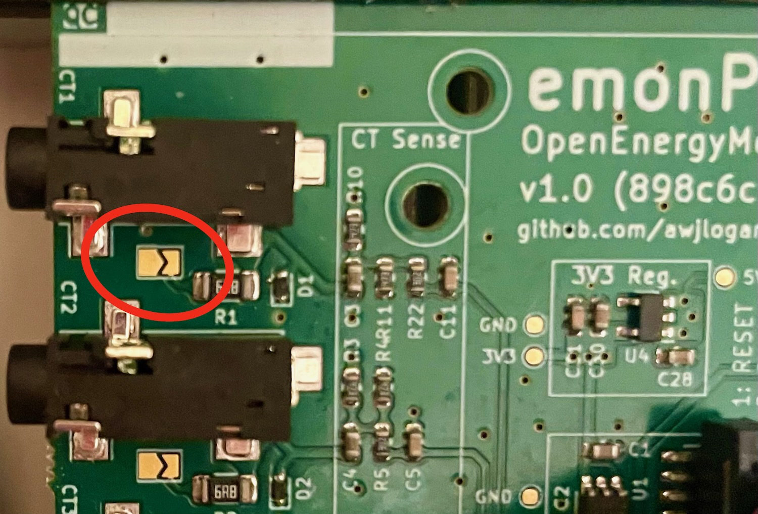

The emonPi3/emonTx6 requires voltage output CT sensors by default. There are 6.8Ω burden resistors included for use with current output sensors, for example the YHDC (blue) 100 A CTs. To use these burden resistors, users can bridge the solder pads next to the 3.5 mm jack. Each CT input channel is independent, so you can have a mix of current and voltage output CTs in use.
Bridge with solder to use burden resistors
  • Note the CT sensor used on each circuit, as well as the channel number on the emonPi3/emonTx6 that the CT is connected to, as this may be required to calibrate the emonPi3/emonTx6 if you are using non standard CT ratings. It’s worth making a physical note of this on a label next to the emonPi3/emonTx6 for future reference.

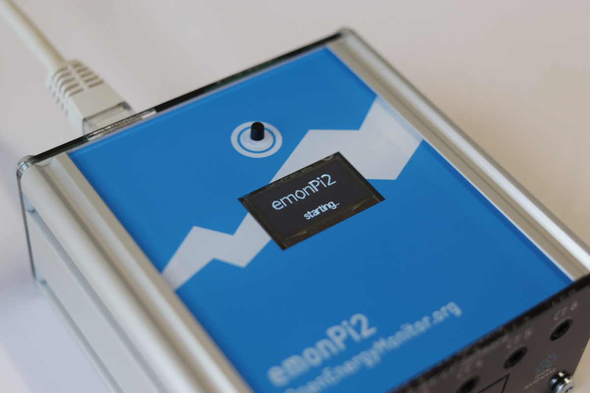

Startup and display menu
With the emonPi3 powered up a simple emonPi3 v1.x.x <commit> message will be printed on the display. <commit> will have the exact version of the firmware. The Raspberry Pi is booting at this point which usually takes around 40 seconds:
emonPi3 startup

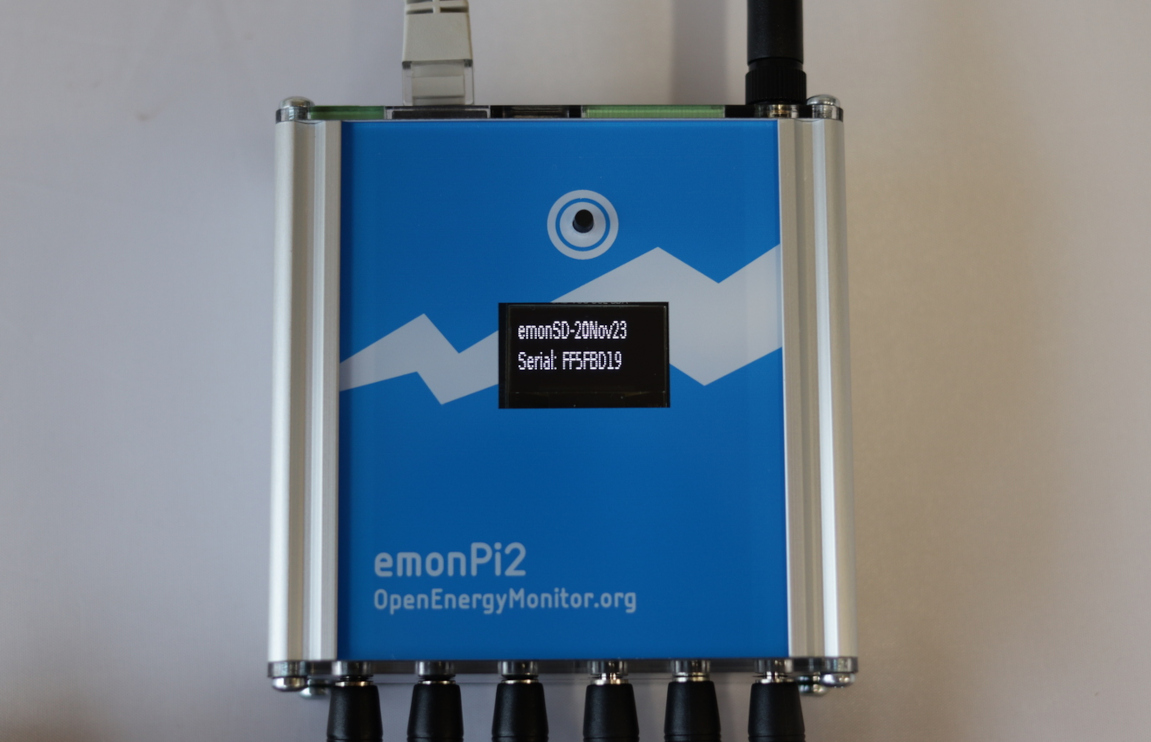

Once booted the display will print the SD card image version and emonPi3 serial number:
Scroll through the display menu by pushing the button above the display. The menu items are:
  1. emonSD image version and hardware serial number.

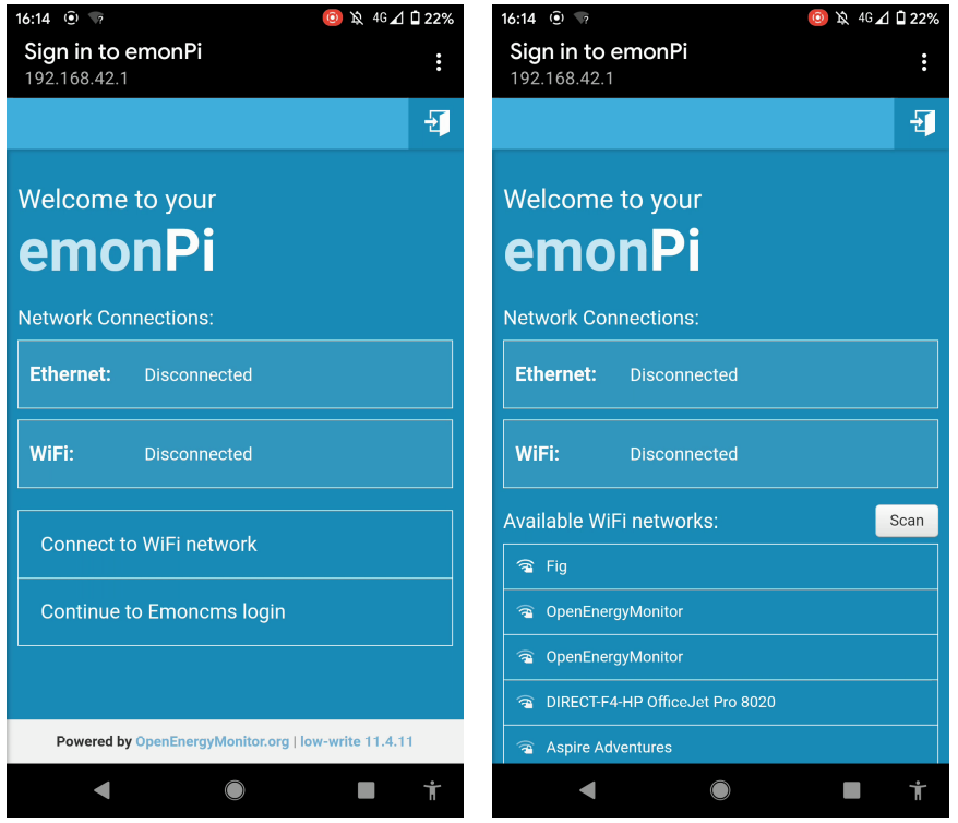

Connecting via WiFi
When the emonPi3 is powered up it will create a WiFi Access Point called emonPi. Connect to this using password emonpi2016. On Android devices a captive portal option should pop up with the option to ‘Sign in’. This will bring up the Wi-Fi configuration interface.
Note
Captive portal and the new WiFi setup interface is available on emonSD_01Feb24 or newer. You may wish to upgrade to the latest emonSD image see the emonSD download section.
Note
While captive portal generally works well on Android phones, the current software version may not always provide a consistent captive portal ‘Sign in’ popup on other devices and browsers. If no ‘Sign in’ option appears browse manually to the IP address http://192.168.42.1.

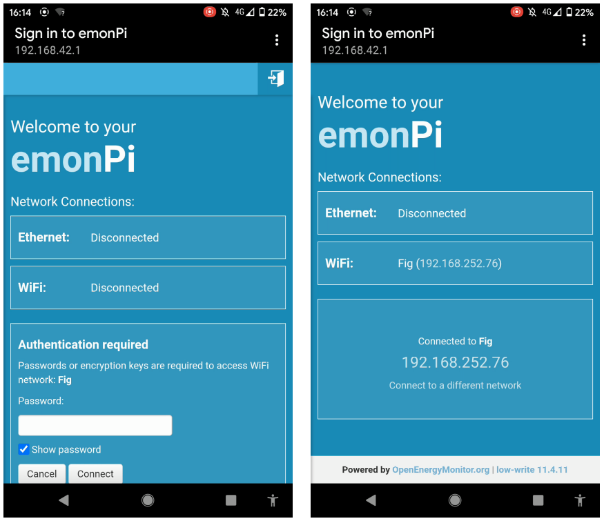

1. Click on ‘Connect to WiFi network’ to show the list of available WiFi networks. Click on the network that you wish to connect to.
2. Enter the WiFi network passkey (often found at the back of the internet router). Click connect. Connecting to a network and relaying the status update back to the user interface typically takes around 20 seconds. Note down the assigned IP address and use this to connect to your emonPi3 once you are connected back to your home WiFi network.
Note
The Pi Zero 2W hardware option will usually drop the access point WiFi connection a few seconds after clicking ‘Connect’. Wait a few seconds, disable and re-enable WiFi on your phone, connect to the emonPi access point again and then bring up the network configuration interface via the ‘Sign in’ captive portal if available. The connection status and IP address can be accessed by reconnecing to the access point in this way.

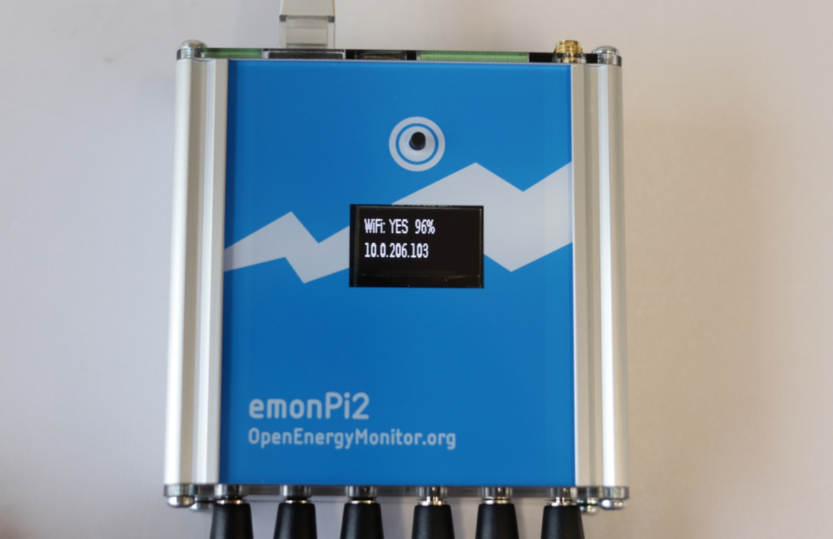

The WiFi IP address can also be accessed by scrolling to page 4 on the emonPi LCD:
The emonPi3 will now present the emoncms login screen. If the Register button is not shown, login with default account username emonsd and password emonsd. We recommend changing the default username and password from the My Account page once logged in.

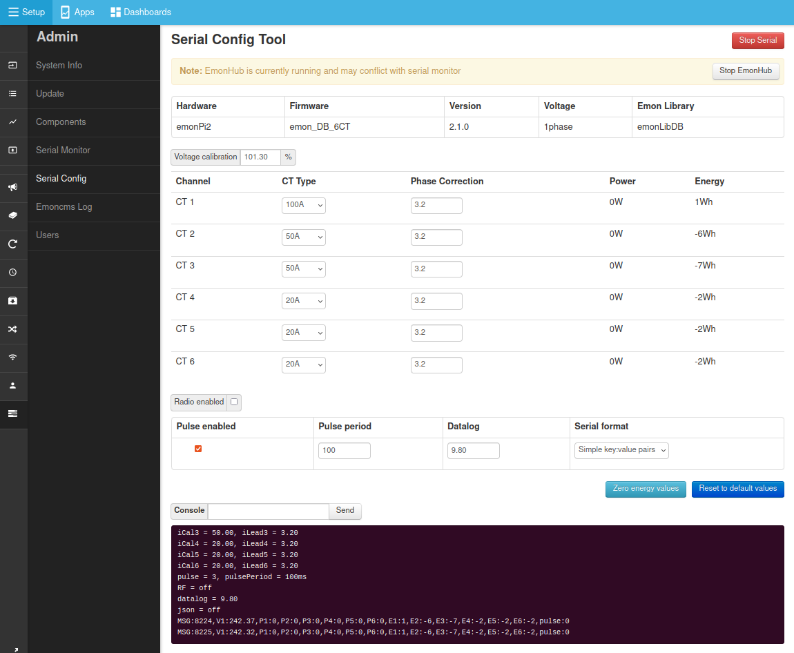

CT calibration selection
Different rating CT sensors e.g 100 A, 50 A, 20 A etc, require differant preset calibrations.
CT calibration is usually pre-configured in the shop as part of the order process, but you may wish to double check that your calibration configuration matches the sockets that you have plugged the CT sensors into at this point.
  • Navigate to Setup > Admin > Serial Config
  • Click on Stop EmonHub to temporarily stop the EmonHub service while we perform calibration.
  • Select serial port /dev/ttyS0 and click Connect.
  • After a couple of seconds the emonPi3 will print out its current configuration which will populate the interface (if it does not do this type l and click Send to reload the calibration details from the emonPi3 measurement board).
  • Adjust the CT rating to match the CT sensor that you have installed on each channel.
  • Click on Save Changes to ensure that the new configuration is recorded such that it persists when you power cycle the board.
  • When finished, click on Stop Serial to disconnect the serial configuration tool and then Start EmonHub to restart the EmonHub service.

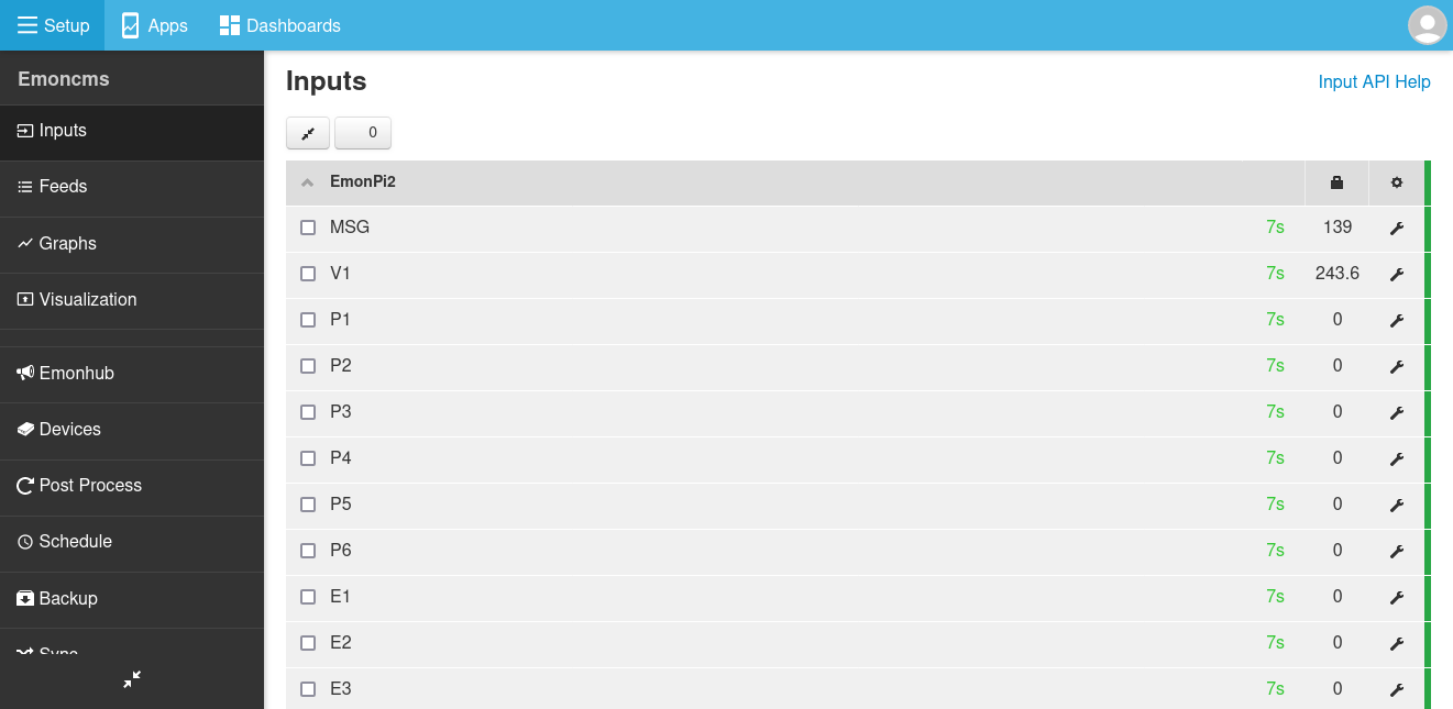

Configure inputs by navigating to Setup > Inputs. The emonPi3 will pop up here automatically under the EmonPi3 node name.
The next step is to log the input data to feeds. Inputs are just placeholders showing the latest values sent from the emonPi3, we need to create feeds if we want to record a time-series of these values. It’s possible to either manually configure each input as required, or if you just want to record everything for now and delete what you don’t need later, then you can use the pre-configured Device Template.
Tip
Input configuration using the emonPi3 device template: On the Setup > Inputs page, Click on the cog icon (top right corner) of the emonPi3 node. The ‘Configure Device’ window will appear, click on ‘emonPi3 Standard’, you may need to scroll down a little in the Devices pane to find. Click ‘Save’ and ‘Initialize’. This will create feeds that record real power and cumulative energy for each channel, Vrms, total message count, temperatures and total pulse count. Navigate to Setup > Feeds to see these feeds.
Manual input configuration: You may only want to record specific channels or apply more complex input processing.
With feeds created, explore the data using the graph view. Navigate to Setup > Feeds and click on a feed of interest to open the graph view. Click on the drop down time selector near the title and select the last hour. Click and drag to zoom further to see the new data coming in.
Try creating an EmonCMS App. Click on the Apps tab. From the Available Apps list select ‘My Electric’ and click ‘Create’, Select a power feed for ‘use’ and cumulative kWh energy feed for ‘use_kwh’ and then click ‘Launch App’. After a few days this will start to show a daily bar graph of consumption alongside the real-time power graph and totals. There are a wide variety of different app’s to choose from depending on the application.
